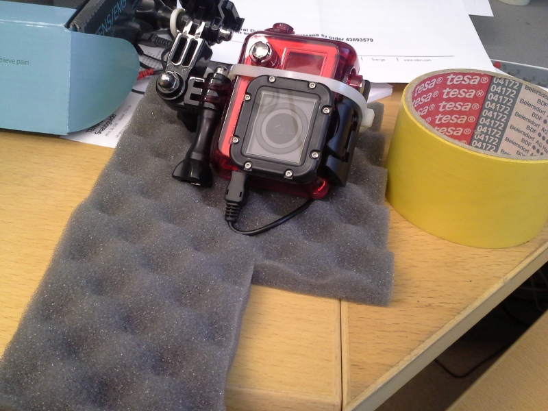

Mer jala skumgummi...
http://www.sporthoj.com/forum/showthrea ... mer!/page2
Ok. Nu jeflar...
2014-08-06 17.47.08_800x600.jpg (206.99 KiB) Visad 12498 gånger
