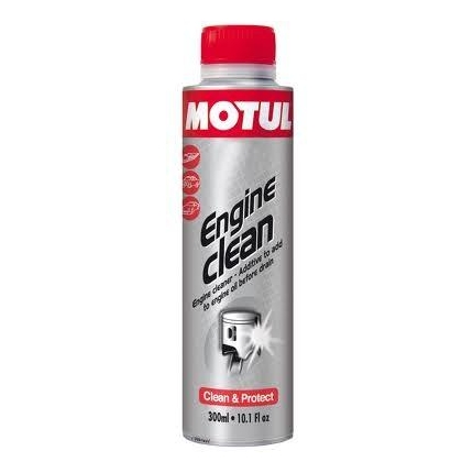

Jag vet och den ska ur rätt snart. Men frågan är om det bara räcker att byta eller om den skulle behöva en rensning?
På tal om det så hittade jag den här hos Motul https://www.motul.com/se/sv/products/oi ... clean-moto som är på 2 dl. Men den ska inte hällas i motorn utan i soppan, så vi får hoppas att CandyManX gjorde rätt här.

Tyrannosaurus! Fel fel fel..... :gnissla :gnissla
Denna använde jag, och den SKA hällas i oljan INNAN olje bytet.... :banana
http://www.jrm-racing.se/oljor/tillsats ... dpwUEMA#77
SAXAT från deras PDF
http://webcache.googleusercontent.com/s ... clnk&gl=us
ENGINE CLEAN
Engine cleaner before drain
Additive to add to engine oil before oil drain
For motorcycle 4 stroke engine
TYPE OF USE
MOTUL ENGINE CLEAN is designed to be used in all types of motorcycle 4 stroke engines, with or
without catalytic converter, using all kind of fuel. MOTUL ENGINE CLEAN effectively cleans
deposits and clogging which appear in the engine. The removed micro-particles are then evacuated
at the time of the oil drain. MOTUL ENGINE CLEAN provides a perfect lubrication during cleaning
process.
PERFORMANCE
MOTUL ENGINE CLEAN, added to engine oil before draining, allows to :
· reduce the wear
· decrease oil and fuel consumption
· increase compressions on all cylinders in the same way
· decrease exhaust pollutants emissions
· evacuate deposits, varnishes and other combustion residues from sensitive areas such as
hydraulics lifters or piston grooves and rings
· take maximum benefit from fresh oil which will fill engine after draining
· increase catalytic converter’s lifetime
RECOMMENDATIONS
:fakta Before each oil drain, add directly in the oil sump a can of ENGINE CLEAN to hot used oil. Let the
engine idling for 15 minutes (without riding).
Drain the oil and change the oil filter. Refill with fresh oil.
Do not exceed the recommended proportion. If necessary, proceed to 2 successive treatments.
Combined with FUEL SYSTEM CLEAN, ENGINE CLEAN provides a very appreciable reduction of
exhaust pollutants emissions.
PROPERTIES
Color Red
Density at 20°C (68°F) NF T 60 101 0.824
Flash point NF T 60 118 40°C (104°F)
Så, då va det utrett..... :fakta
